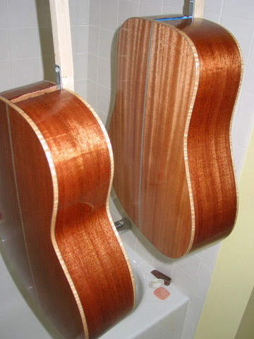

[QUOTE=ToddStock] I really like 'hog and curly maple...and I'm sure John can bend you up a nice set of bindings, as well as LMI. Might want to get them with the side purflings attached if you are going that route. StewMac binding tape works really well.
That's beautiful. How can I get my mahogany to look like that??
Sam -- I agree about the herringbone. John Hall has some good prices on bent binding, so I'll probably go with him (thinking koa or maple). I think I'm going to chuck the herringbone purfling as well -- tone it down a bit, and maybe go with no purfling even.
